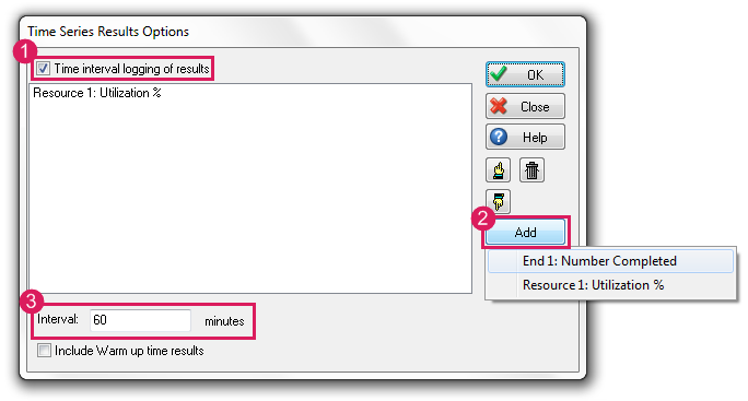

For any object results that you would like to measure, first you will need to add them to your KPI Summary.
Next, open the Time Interval Results from the Results Manager dropdown on the Home Tab .
1. Enable the Time Series Results collection
2. Add your KPIs
3. Set the time interval
If you have a warm up time in your simulation, you can choose to include this as part of your Time Interval Results.
You will then be able to access your results by a generated spreadsheet named Time Interval Results.

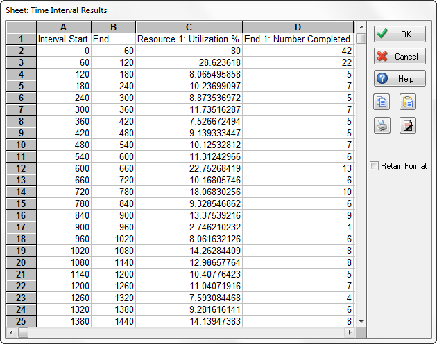

Accessing the Time Interval Results for Analysis
Access this spreadsheet either by navigating to the Home Tab > Results Manager Dropdown > Time Interval Results > View
or
by navigating to the Data and Rules Tab > Spreadsheets Dropdown > Time Interval Results.
Looking at the spreadsheet, the first two columns represent the start and end times of the results interval, while the results themselves are reflected in the subsequent columns.
Note that the results presented are the results for that specific interval, and are not cumulative. Below is an example spreadsheet produced by the Time Interval Results feature.
