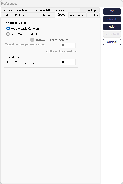

Access the following speed options from Preferences.
Controls the speed that the simulation animation is displayed.
Speed Control
A value between 0 - 100 where 100 means no animation is shown and the simulation is run at full speed. This correlates to the position of the main speedbar.
Per Real Second
Used to slow the simulation down when the speed setting = 10. If you set this to 60 and speed to 10 you will see one hour of simulated time per real second (on your watch!) …. if your computer is fast enough!
