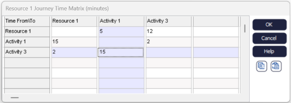

Travel Matrix
The Matrix of all Journey Times button allows a matrix of all the programmed Resource Travel Times to be seen. This matrix is editable and allows copying and pasting of data.
If you have a lot of travel times or times that vary on the return journey, the travel matrix is the ideal way to view all your Travel Times.

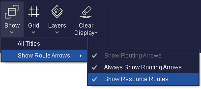

Resource Travel Arrows
Resource Travel Arrows can be shown by selecting the arrow beside the Show Hide Routing Arrows button and then selecting Show Resource Routes. Resource Travel Arrows can be bent in the same way as other arrows.
