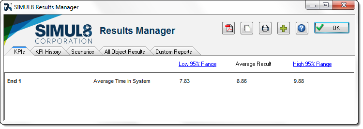

Confidence Intervals
When you run a trial your KPI summary results are displayed as confidence intervals rather than just single numbers.
The central column of figures gives the result averaged across the weeks in the trial. This gives a guide as to what we expect the long term average to be.
The left and right columns give you an indication of how reliable the central (average) figure is. In some cases, the average figure may be very reliable because, perhaps, there is little variation from week to week. In other cases, it may be less reliable. The confidence intervals help you establish how much trust you should put in the single average value. For example, an average of 50 when alternate weeks swing from 0 to 100 is very different, in terms of reliability, from an average of 50 when they vary only between 49 and 51!.
Please note that the right and left values are confidence intervals of the results obtained during a Trial Run. When selecting the 95% limit, these values give you an idea of what the average value is going to be on 95% of the times. 80%, 90%, 98%, 99.8% and 99.9% limits are available by right clicking the mouse on where it says either Low 95% Range or High 95% Range.
