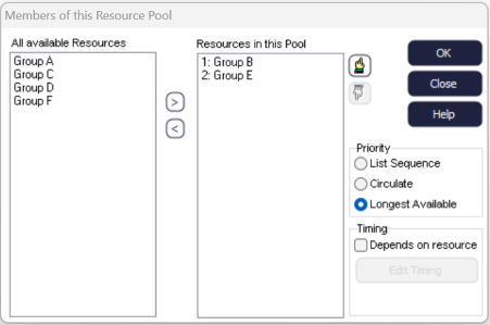

First thing we wish to do is create pools of individual agents based on their skill level. Create 3 Pools in the usual way – See Pooled Resources
Pool 1 contains agents with Skillset value 1, Pool 2 contains agents with skill set 2 and Pool 3 contains agents with skill set 3. We then want to select how these groups will be prioritized, in this example we will use the longest available as this reflects the rules of selection above.
Call Type 1 – Skill Level 1 Example

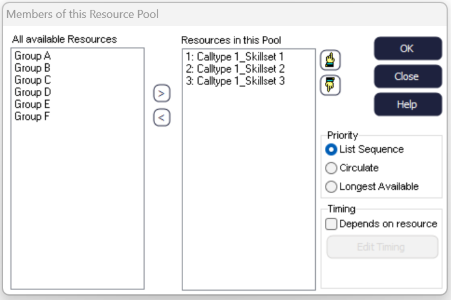

Once we have created the 3 skill level pools we then want to create a final pool which contains the skill level pools. We then want to select the list sequence as our priority discipline to ensure that we first of all look for an agent of the highest skill level and then as we set up previously select the agent of the highest skill level who has been idle the longest.
Call Type 1 Total Pool Example
Pooled resources are now available in the list of all available giving the ability of pools within pools.
This final pool can then be assigned to an activity in the usual way.

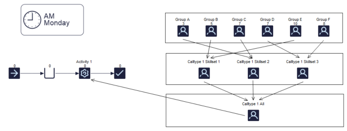

Below is a graphical representation built in Simul8.
