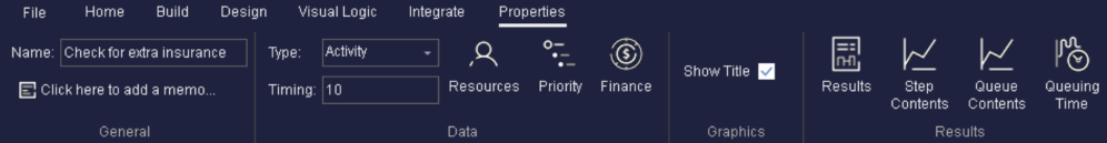

Activity Properties
To inspect or change the Activity's parameters select it and it's contextual ribbon tab will open. Alternatively double click on the Activity on the simulation window, this will open the Activity Dialog box.
- Type - The BPMN sub type for this object
- Timing - The average time it will take this activity to process one work item
- Memo - Add some extra notes about the activity
- Priority - Say which Activity has priority for free resources
- Finance - Add costing information to be able to calculate cost impact of your process
- Results - After the simulation run, see how your activity performed
- Step contents - Creates a chart that shows you the contents of the step over time during the simulation run
- Queue contents - Creates a chart that shows you the contents of the queue for the step over time during the simulation run
- Queuing time - Creates a bar chart that shows the distribution of the time work spent queuing for the step before it could be processed
