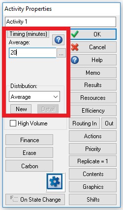

Double click on the Activity to open its properties.
You will now see a dialog box that gives you access to an enormous number of parameters and settings that can be used to configure how work is done.
For now, just change the number in the box labeled “Average” from 10.00 to 20.00.
Click the OK button to go back to the main simulation screen and then click the RUN button.
Once the simulation has run, take another look at the RESULTS inside the End Point object.
