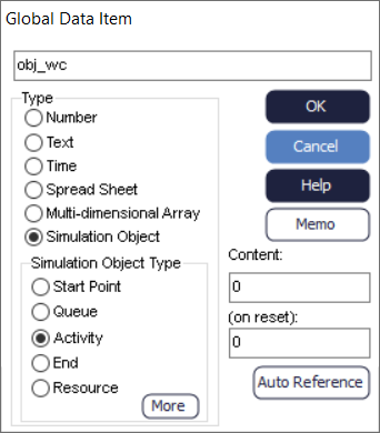

Object: an Object variable of type (e.g. obj_wc for Activity), this parameter is created in the Data Store in the Build tab as in the image below.
