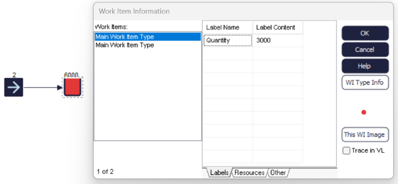

Checking the High Volume box on a Queue means that:
- The Queue Count (displayed on top of the Queue) refers to the sum of all QUANTITY Label of Work Items in the Queue. For example, if your QUANTITY Label is set to a fixed value of 3000 and 2 Work Items entered the Queue, its count will be 6000.
- If you set a capacity for the Queue, it will refer to the sum of the QUANTITY Label. If the capacity is 4000 and there is already a Work Item with a QUANTITY Label of 3000, no other Work Item will be able to enter the Queue.
