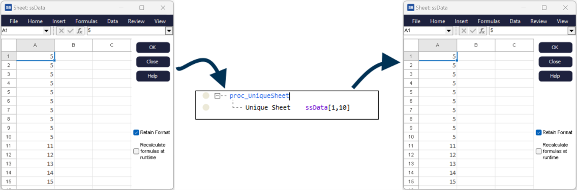

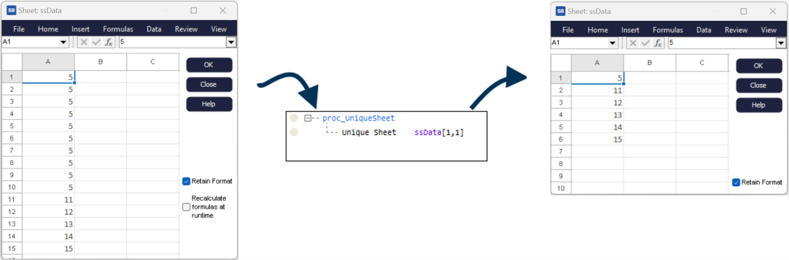

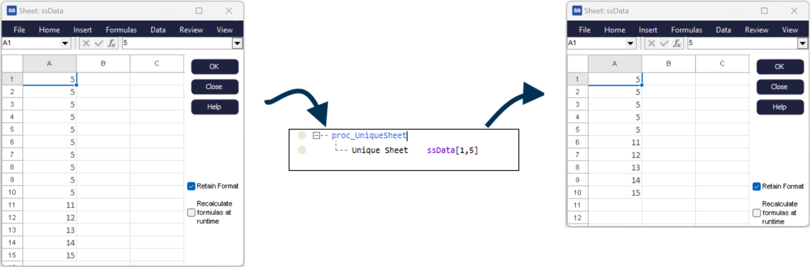

Spreadsheet rows are removed if the specified column cell is identical to the cell above
Typically only used with sort sheet, this command removes rows that are duplicates and shifts up rows into the blank space. Only designed to work if the sheet is already sorted, but does not sort the sheet first because there might be cases where it is useful for non-sorted sheets. “Duplicate” is checked in one column only.
Parameters
  • Spreadsheet - Spreadsheet column to check for uniqueness, rows above are not checked
Examples
