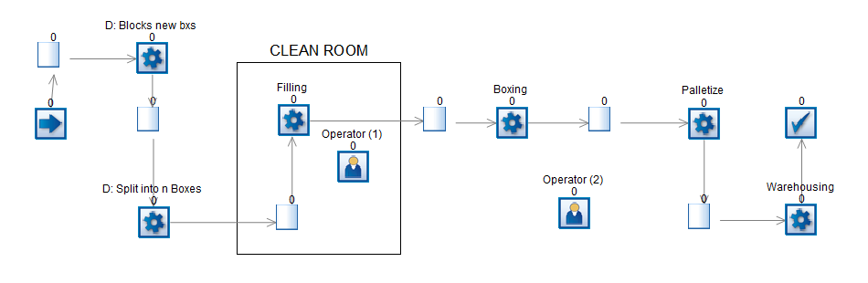

In FFIC’s current packaging setup, bulk material is fed into a clean-room environment where filling takes place one container at a time. Due to the clean-room requirements, this process requires at least one operator at all times.
Once the containers are filled, they are then passed down a conveyor outside of the clean-room, through a boxing station, onto palletizing and finally warehousing, where non-clean-room activities are performed by a second operator.
The line operates on a five day by eight hour shift schedule, where filling equipment is cleaned at the start and end of each shift, as well as during the arrival of new bulk material.
Building the baseline simulation
Using Simul8 for the first time, FFIC’s Project Manager, Eric Kurtz, was quickly able to simulate this entire packing line process and resource.
Existing plant metrics were utilized to confirm the accuracy of the baseline simulation model, allowing the impact of improvement scenario simulations to be properly assessed.

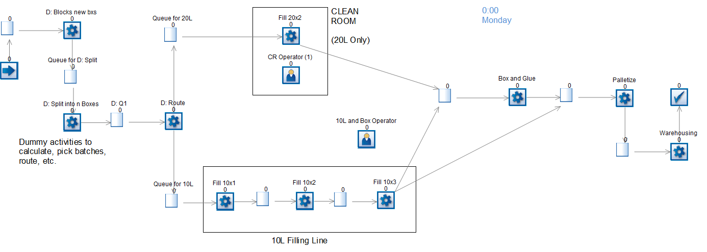

To overcome these bottlenecks, a range of process improvement ideas were suggested for evaluation using Simul8, including:
- Removal of the clean-room requirement (allowing one operator to move to other production activities)
- Installing new two or four multi-head filler equipment, providing a parallel 10L packaging line
- Reducing production setup and changeover times
- Modifying operator shift patterns
- Changing the number of available operators

From these findings and the results of the other simulation scenarios, it was recommended that FFIC scope and install a four-head semi-automated filling line.
Why was this chosen as the recommended solution?
Although the four-head semi-automated filling line option requires the largest up-front capital cost, the small increase in capital over a two-head filler was found to provide an increase in overall capacity of more than 10 tonnes per month in comparison.
Combining this four-head filler option with three operators (one for clean-room activities and two for the rest of the line), was also found to provide a potential 338% increase in throughput and a 29% increase in total asset utilization in five years.
This option also provides FFIC with flexibility to increase overall system throughput over time. As it will take some time to reach projected demand, the four-head filler can initially operate as a two-head, and then be expanded to four-heads when needed.
