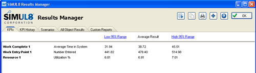

All of these results can be added to the Results Manager. Hover over the result you want to add, and right click when a larger black arrow appears. This adds your result to the manager; if you want to remove a result, simply right click again to toggle the requirement off.

Run a Trial using the Trials option on the Home Tab. The Results Manager automatically produces upper and lower 95% Confidence Intervals. This can be interpreted as - on 95 occasions out of 100 result between the upper and lower 95% range figures is predicted.
